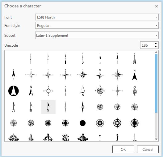

But if I want to change the style of the north arrow, how would I do that?  The north arrow styles are types of fonts:
north arrow styles in font set

Refer to my response on your scale bar question. https://community.esri.com/message/766351-create-a-double-fill-scale-bar?et=watches.email.thread. Change scale bars for North arrows. e.g.
var northArrowItems = arcgis_2d.SearchNorthArrows("");
North arrows are style items not fonts in Pro (even though there are esri fonts that contain north arrow characters)
