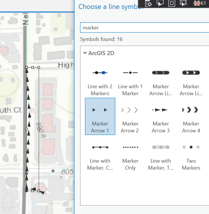

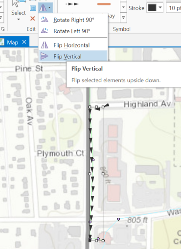

I would like to rotate/ flip a graphic element using the Pro SDK but could not find any references for doing this.
See below images for reference.
Line element with marker arrow symbol
Marker arrow symbol after vertical flip
Below is the code snippet of how I'm creating an element. How can I rotate or flip it while creating it?
CIMSymbolReference symbolReference = SymbologyHelper.GetLineSymbolReference("Marker Arrow 1");
CIMLineGraphic cimGraphicElement = new CIMLineGraphic
Line = geometry as Polyline,
Symbol = symbolReference
graphicsLayer.AddElement(cimGraphicElement);

Hi,
I think you need to rotate geometry first (before creating cimGraphicElement). It could be done by using GeometryEngine Rotate method. More info here:
https://pro.arcgis.com/en/pro-app/latest/sdk/api-reference/#topic8281.html
