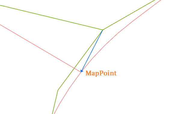

At the given point it should return 3 red lines and 1 blue line. But it is returning the green line too. Why does this green line return without intersecting? (Pro SDK 3.4)
SelectionSet selectionSet = MapView.Active.GetFeaturesEx(mapPoint.Extent,true,true);

Is there a reason for using mapPoint.Extent instead of just mapPoint? Also it seems you've got the whollyWithin parameter set to 'true'. I'd try using just mapPoint and setting whollyWithin to the default 'false'.

Nothing specific, I have not used mapPoint.Extent it returns all three green lines. If I change to default 'false' the result remains the same.
