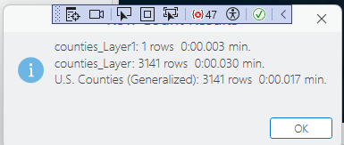

I don't see another way, however, i think processing will be fast since the layer data is cached in memory.  Here is my sample:
3141 records in 0.017 seconds.
These are the code changes to measure the timing:

ChrisRobles
That worked great thank you!
