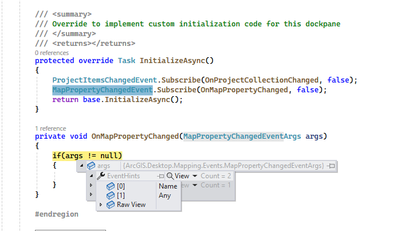

GKmieliauskas
Hi,
You need to subscribe to MapPropertyChangedEvent.
EventHints will show Name property
GKmieliauskas
Hi,
