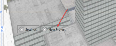

In your configuration, when\where are you running the above snippet to create an empty project?
For example, in order to reproduce your crash, I added a "New Project" button to the startup page in the Configuration Project template. I couldn't repro the crash with this workflow I tried.
