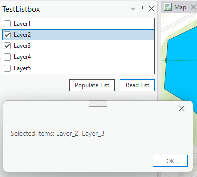

I couldn't quite figure out what you were trying to do, but if you are populating a list and creating layers from the selection (checkbox) on that list like shown below, i simplified your code a bit:
the simplified XAML looks like this:
<ListBox Grid.Row="0" Margin="5" ItemsSource="{Binding MyLayers}"
					ItemContainerStyle="{DynamicResource Esri_ListBoxItemHighlightBrush}"
					SelectedItem="{Binding MyLayersSelection}"
					BorderBrush="{DynamicResource Esri_TextControlBrush}" >
  <ListBox.ItemTemplate>
    <DataTemplate>
      <StackPanel>
        <CheckBox Content="{Binding Name}" IsChecked="{Binding IsChecked}"/>
      </StackPanel>
    </DataTemplate>
  </ListBox.ItemTemplate>
</ListBox>
and the code behind looks like this:
private ObservableCollection<MyLayer> _myLayers = new ObservableCollection<MyLayer>();
/// <summary>
/// This is the list of MyLayer objects
/// </summary>
public ObservableCollection<MyLayer> MyLayers
  get { return _myLayers; }
  set
        SetProperty(ref _myLayers, value, () => MyLayers);
i attached my 3.0 test add-in.  If you need to act upon individual checkbox changed events the MyLayer class has to implement INotifyPropertyChanged.

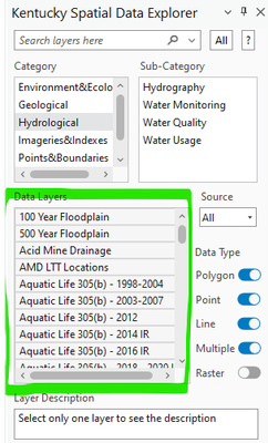

Amadeus111
@Wolf Thanks for the reply but checkbox for each item is not a good option for me. It gets more space and users need to check them all.
Here is the UI:
Users select the layers (strings at this point) from the highlighted listbox and click a button. All selected layers found in a string array dictionary and created and add to the TOC. In some cases, there are more than 40 layers. So, I created a button which selects the all layers in the listbox. It looks like all layers selected in the UI. However, when I put them in the loop to check their IsSelected property. It says only 12 of them selected. If I play with the scroll it shows more selected. I even tried auto scroll end of the listbox but still not all selected.
I hope it is more clear now. It is a weird problem ad difficult to explain too
Amadeus111
Finally, I found the problem. I was making the selection (ListBox.SelectAll()) in the code-behind. I didnt know it was going to be problem. The issue was gone. As soon as I carried that into the view-model.
@Wolf  I appreciate your help anyway. Somehow, my problems are gone as soon as you post an answer to my questions 😄
