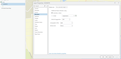

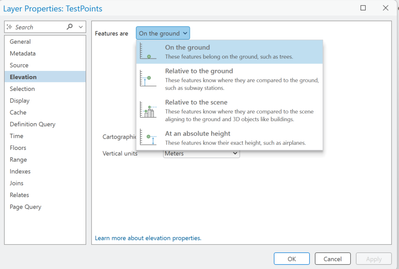

For the new layer, if you access the layer properties, what setting do you see under Elevation? Perhaps change this setting to see if your points are visible.
Daniel4
Hi Uma, the settings are set to 'absoulute height'.
I have tried to change the settings, but the feature layer are not drawn.
