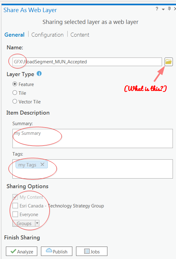

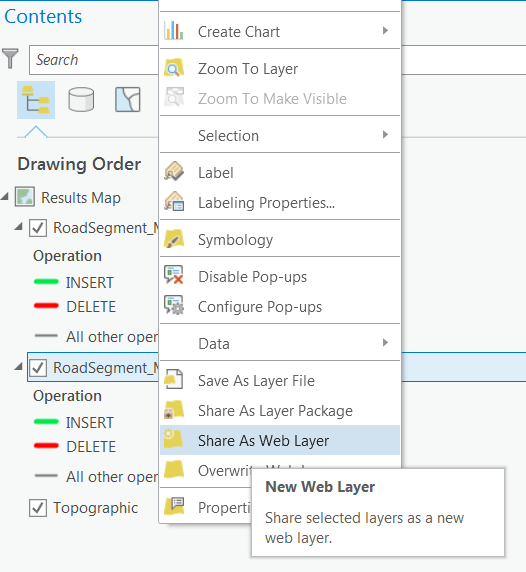

Using ArcGIS Pro 2.0(1) SDK, how can I initiate the command "Share as Web Layer" as I do from the popup menu on the layer from the content dialog:
Also, how can I pre-populate the parameters of the tool:
I need the user just to check and click Publish...

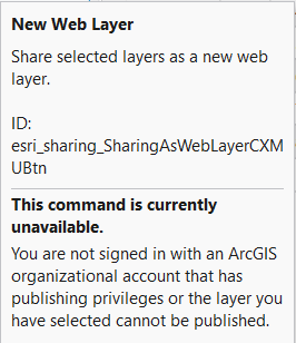

You can open "New WEB layer" using ID (esri_sharing_SharingAsWEBLayerCXMUBtn)
var commandId = "esri_sharing_SharingAsWEBLayerCXMUBtn";
IPlugInWrapper wrapper = FrameworkApplication.GetPlugInWrapper(commandId);
var command = wrapper as ICommand;
if ((command != null) && command.CanExecute(null))
  command.Execute(null);

ICommand.Execute didn't work because i had no selected layer, or the layer selected was not the correct type. Still it only opens the dialog, i guess it doesn't support args..
