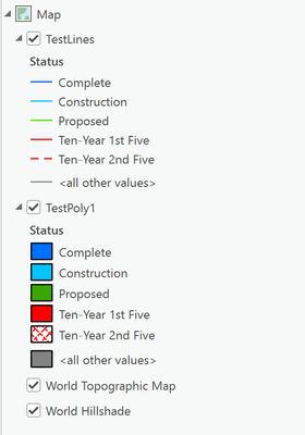

I have tested your code on ArcGIS Pro 3.5 and can say the same as @UmaHarano . It works as in Uma's screenshot.

I used your code on a mock up data set with "status" fields. It seems to work for me. I can't see anything wrong with the code. We will have to debug with your data to see what is actually happening.
