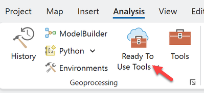

UmaHarano
@MichaelAustinESGG
The Bookmark control is a Gallery control. Pro's "Ready To Use Tools" control on the Analysis tab is also a gallery.
The Pro SDK Item template for Gallery will get you started with this.
