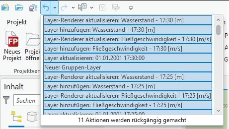

Doing so, each single action is shown in the Undo Stack.
But from the user's perspective, this should be only one single action / operation.

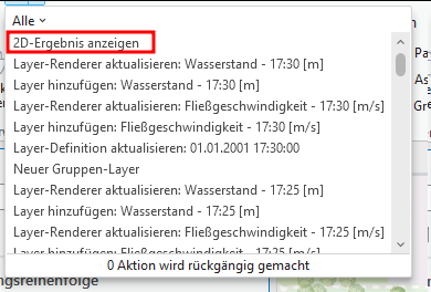

Reply to suggestion 2:
It seems like the new Operation "2D-Ergebnis anzeigen" that should encapsulate the others only comes on top of the others.

Regarding 2 - The operation should come at the top like you have in your screenshot. I had a QueudTask in the Do method that reversed the order. Attaching the fixed sample.

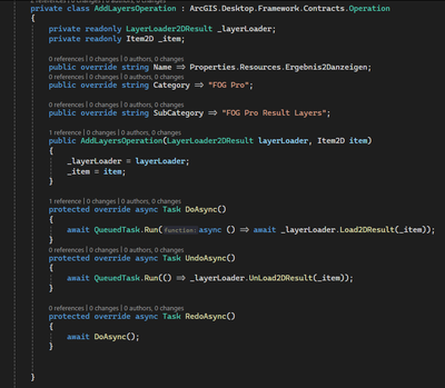

right, the QueuedTask.Run in the Do Method was not awaited.
I did not use the Do method but only implemented and used the DoAsync Method, using a QueuedTask.Run inside, like this:
(The Load2DResult method is async because the is some geoprocessing done inside among others.
That is why the DoAsync method is a bit complicated with all the awaits.)
But I am searching for a way to avoid all the other entries in the undo stack.
As I have seen from the screenshot above, the entry "New group layer" occurs although LayerFactory.Instance.CreateGroupLayer is done during the Do method of the MyAddLayersOperation.
So have I understood right, die Operation serves to have an additional entry on the undo stack, I can click on and it can provide methods to Undo and Redo the action.
UmaHarano
Exactly!
Unfortunately, there is no way to avoid having all the other entries right now.
