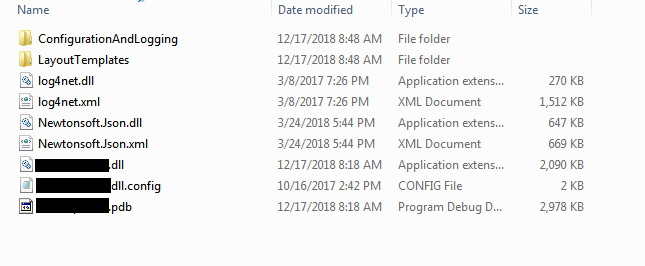

Still stuck on why this happens sometime and not others.  So it appears that when a NEW/UPDATED version of the .proConfigX becomes available in the ConfigurationFolder, it unpacks that folder to the assembly cache.  But it appears that sometimes it either doesn't unpack it fully or ontime or maybe it is locked out from making the update?  The only way to then rectifiy the situation is to blow away the assembly cache item and restart the configuration.  Not a big deal to do, but when dealing with many users it is a problem.
What I mean by this (fully or ontime or maybe it is locked), is that when I have seen this on a users machine, the only thing in their assembly cache are the .dlls associated with the configuration; the .config file, the .xml files, and the Content Folders are not present.  They have not been unpacked.  My application has 2 Content folders, and when these are missing, the program will crash as it cannot locate some of the settings located in the content folders or the .config file.

We found an issue with Configurations at 2.2  - In this scenario, while a Configuration is running if a 2nd instance of Pro is launched, the AssemblyCache gets deleted. This includes the files that the configuration requires.. After closing all the instances of Pro and the Configuration, if the same Configuration is relaunched, an Application crash was encountered (Assembly Cache does not get repopulated with the files the Configuration requires).  We have now fixed this issue in 2.3, which is to be released soon.
This sounds very similar to the issue you are experiencing.
