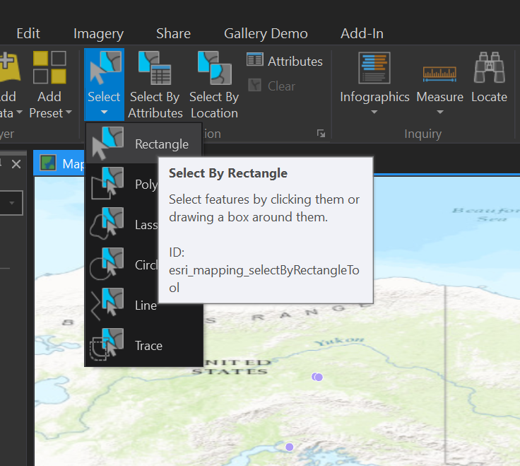

UmaHarano
Glad you found it!
The IDs are listed in the Pro SDK wiki pages in this page:  ArcGIS Pro DAML ID Reference
You can also see them in Pro when you enable the control IDs to be displayed.
Control IDs
Also, there is a Pro SDK Utility that you could use to get the DAML ids directly into you Add-in solution.
