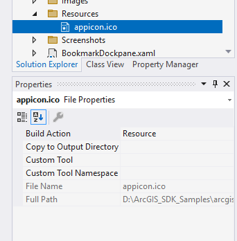

GKmieliauskas
Hi,
As was described in your link, change of Image in daml will change image of your AddIn in Add In Manager of ArcGIS Pro.
You need WPF way to change window icon. Add *.ico file to your AddIn resources and set build Action to "Resource"
Open your ProWindow xaml and set Icon property:
<controls:ProWindow x:Class="DockpaneSimple.ProWindow1"
        xmlns="http://schemas.microsoft.com/winfx/2006/xaml/presentation"
        xmlns:controls="clr-namespace:ArcGIS.Desktop.Framework.Controls;assembly=ArcGIS.Desktop.Framework"
        xmlns:x="http://schemas.microsoft.com/winfx/2006/xaml"
        xmlns:d="http://schemas.microsoft.com/expression/blend/2008"
        xmlns:mc="http://schemas.openxmlformats.org/markup-compatibility/2006"
        xmlns:extensions="clr-namespace:ArcGIS.Desktop.Extensions;assembly=ArcGIS.Desktop.Extensions"
        mc:Ignorable="d"
        Title="ProWindow1" Height="300" Width="300"
        Icon="resources\appicon.ico"
        WindowStartupLocation="CenterOwner"
And you will get:
