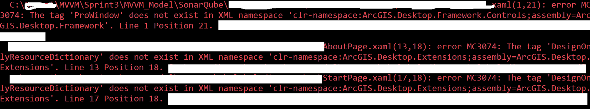

Hi All,
     I am also getting same issue.
I have tried to analyze the code using "SonarQube" from my local desktop and i am also getting same error.
Please help us.
