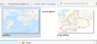

Mannus_Etten
thanks, yeah looks good but still I do have some questions.
the button with the arrow can show a list of items. But the list is empty and the busy indicator will never go away... How can i hide the busy indicator and show for example a text 'no items available' ?
The second thing is the thumbnails. I marked in yellow the text 'meetvakken'. That is visible over the thumbnail.
If you open the gallery you see that meetvakken is an item without a thumbnail...
how can i prevent that the title is placed over the thumbnails?
