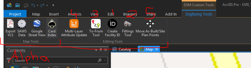

Just wondering what the best way would be to arrange tools on a Custom Ribbon.  There doesn't seem to be a way for the end-user to do it through the ArcPro GUI, so does this have to be done through DAML code??
Here is what I currently have;  one custom ribbon, divided into two groups.  The first group (Map Tools) I'd like to arrange alphabetically in ASC order.  The second group I would like to arrange in a specific order specified by the numbers in the pic.
For either group, tools will be added going forward, so I'd like the first group to remain alphabetic and then be able to squeeze tools into the right place for the second group as I create them.

I'm stuck at trying to figure out how to get the buttons in the order I desire.

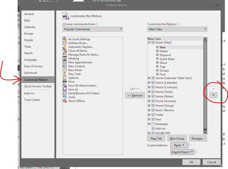

Here is a screenshot of the "Customize Ribbon" from MS Outlook.  It has the Up/Down buttons, which work to arrange buttons on ribbons.  It seems like ArcPro is missing the two buttons I have in the red circle to organize Ribbons.
