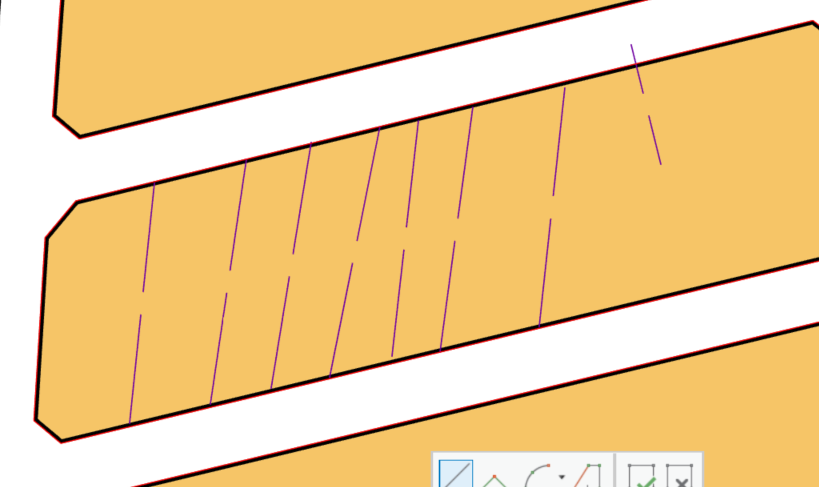

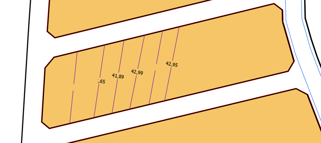

Hi,
We are develope commands for arcgis pro sdk 2.2 version.We have developed the "Intermediate distance writing " tool.Tool lines are feature class, distance string is the annotation .But annotation (distance string) when I create new one store annotation correctly in  table but  not shown stable in map. When create a new sometimes when I use zoom in/out (change scale), some annotations or all annotations don not display.When I create a new one sometimes all the annotations appear.  Here is the Pictures and Codes below. How can I solve this problem ? Could this problem be a bug?
Pictures:
annotation1
annotation2
Codes:

5 Replies
tanerkoka
Hi,
İs there any progress in the question above ?
Thanks for helping

tanerkoka
Hi,
I've added the line in the code above with the bold font, but nothing has changed. Do I have to add or remove anything in the code ? Can you help me ?Here is code below:

tanerkoka
Hi,
Is there any improvement in the above question?  Is it a bug? Because our customers waiting for this.
Thanks
CharlesMacleod
I cannot reproduce your issue in either 2.2 or our next release (not yet available) 2.3. The placement of your context.Invalidate statements are correct.
Please work with ESRI tech support to resolve your issue. They will most likely need a copy of your data as well.
