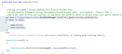

Hi,
I've a last question.
I found that the method i was looking for is "OpenToolDialog", but i've noticed that the tool script doesn't load the first time if the geoprocessing pane isn't opened (ONLY THE FIRST TIME THERE'S THIS BUG). Do you have some suggestion?
pspada_WT
I've figured out how to overcome this problem.
In the onClick event I add the event of Pin and UnPin of the geoprocessing pane.
