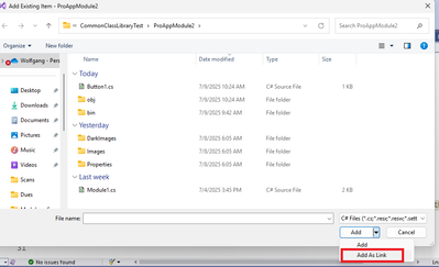

The ArcGIS Pro SDK community samples repo contains an example of two Add-ins interfacing.  Under the Framework folder you'll find AddInOne and AddInTwo and the shared component AddInShared.
If you have a reusable versioned class library, you'll have to sign the add-in (and library) as @SelimDissem  said above. If you just want to 'share' common source code between your two Add-ins you can also add a reference to your 'shared' CS source code as shown here (in which case, you don't need to worry about DLL versions):
