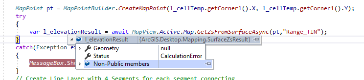

Using GetZsFromSurfaceAsync with or without the second optional parameter always returns an error.  See screen shot of l_elevationResult contents... What am I doing wrong?  No matter what I try I keep getting Geometry as null and Status as CalculationError as shown in screen shot.  Thanks!
MapPoint pt = MapPointBuilder.CreateMapPoint(l_cellTemp.getCorner1().X, l_cellTemp.getCorner1().Y);
try
    var l_elevationResult = await MapView.Active.Map.GetZsFromSurfaceAsync(pt,"Range_TIN");
catch(Exception ex)
    MessageBox.Show(ex.Message);

Ok... Just some clarification....   The "pop-up" in the second screen shot of original post is from placing a break point on the closing brace following the call to MapView.Active.Map.GetZsFromSurfaceAsync and when they break point was hit I hovered over the l_elevationResult to show the dialog in the screen shot.

The OverlayGroundSurface sample in the "ArcGIS Pro SDK Community Samples" GitHub Repo is using GetZsFromSurfaceAsync.  It should work for a single point.  However, I think you have to specify the correct spatial reference when you create your test point.
DHuantes
Excellent... Didn't have a chance to look until just now.  I was talking to ESRI Tech Support and they mentioned your reply.  So I went ahead and tried it using MapView.Active.Map.SpatialReference as the spatial reference argument when instantiating my MapPoint and it resolve the problem.   Thank you!
