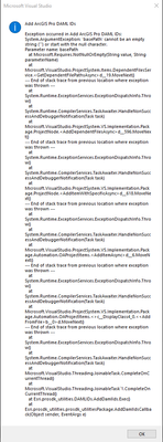

I want to add an ArcGIS Pro Gallery to my project, but after naming it only a cs file is created, but no template xaml file, and the gallery isn't reflected in the config daml file either. I also checked and it is not only the gallery, it is any item from the ArcGIS Pro Add-ins group.
Instead I receive this error message

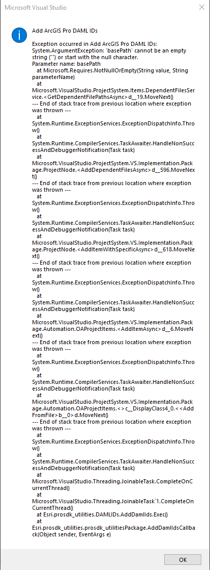

In addition I got this error message when trying to add ArcGIS Pro DAML IDs
