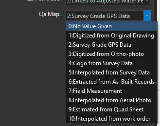

I'm looking for a way to get a coded domain list based on it's name so that I can use on as combo box items in a custom dockpane or control.  Am I missing the easy way to do this? There doesn't seem to be a way to do this from a workspace. There is a sample that shows how to query them directly from gdb_items in the database.  I've also been able to access them through a feature but that isn't a very direct method.  I'm currently hard coding the values and descriptions as shown in the image.  I would rather not do that for obvious reasons.
