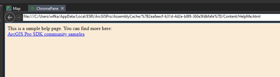

I modified and attached that sample to include a local html file - I followed the instructions from my link listed in my previous post.  When you run the sample you can duplicate your use case with the add-in like this:
