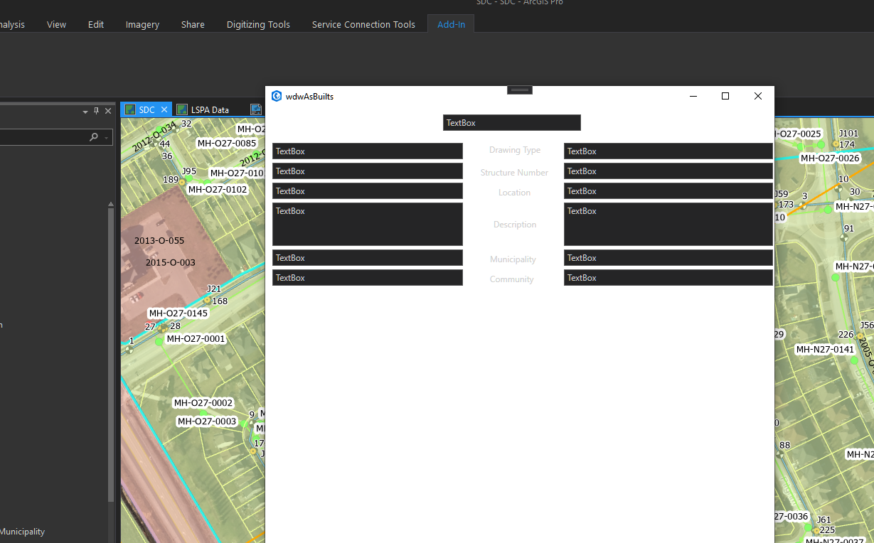

Hi.  Just looking for some guidance on creating WPF Windows and methods on dealing with Light/Dark themes of ArcGIS Pro.  Are there any best practices so that things look nice regardless of what theme the end user might have selected.  As an example, this Window I am working on looks acceptable under the Light theme, but on the Dark theme it looks like total **bleep**.

The Wiki has all kinds of details on how to handle this.  The main trick is to use the correct Style assignment in the XAML of your window. As long as you do this, then it should look consistent in both light and dark themes.
See ProGuide Style Guide · Esri/arcgis-pro-sdk Wiki · GitHub.
And check out the rest of the wiki - there are pro guides and snippets.  This was a huge hep for me personally when I was setting up our configuration and getting things working.
Kris

Thanks Kris!!  I always forget about the style guide links when troubleshooting WPF stuff.  That was very helpful and super easy to implement.
