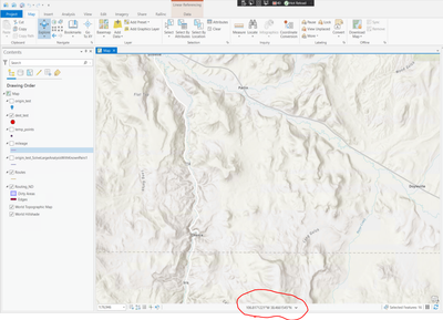

Want to access the X Y of the mouse cursor programmatically to to access inside of a button controls onClick.
I want to be able to access the values circled in red (Screntshot) from an Add-In  button control
