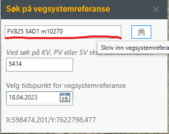

I am trying to create a MapTool that allows the user to find a location based on a string road reference.
The user can enter the road reference in a textblock in an Embeddable Control, and hit enter or click a search button, and the maptool will then send a request to an API that returns the coordinates of  the road reference. 
The coordinates is then used to make a mappoint that is added to the map as a graphic. And I also want these graphics to be disposed when the maptool is closed.
I have bound a ICommand in the EmbeddableControls viewmodel, to the textblock and search button which in turn run a method in Module1 which handles the search-request to the road-reference API.

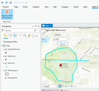

Or you can look at the attached sample that stores a reference to the MapTool in the Module class and uses the MapTools AddOverlay method.   However, when you switch the tool the map point on the map will disappear.  The tool looks like this:
TorRøkkumBørset
This worked like a charm. Thanks a bunch Wolf, this makes it so much easier to work with graphics when I gain access to the MapTool overlay instead.
