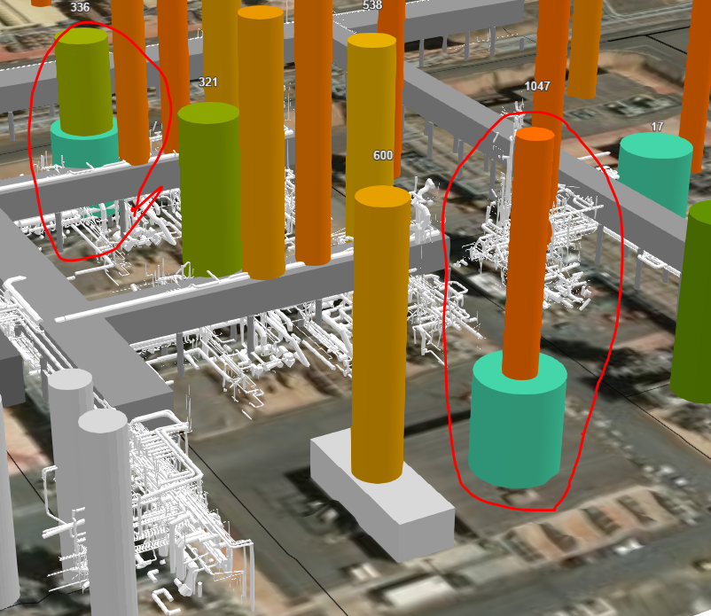

I have a requirement to support in both ArcGIS pro and web site.
For graphic presentation for the hole is quite challenging for me to do with ArcGIS pro sdk.
With ArcGIS js I managed to achieve like this.
I just need to change elevation value to become negative to be underground.
How I can achieve this in ArcGIS pro sdk scene layer?

I want to represent the drilled hole in 3d scene.
Each depth to present as color, width to be present as cylinder, I am happy to stack multiple cylinder in one location as well.
Look like the screenshot is gone in my post,
I add as attachment. (3dcylinder.png)
I did it with ArcGIS js 3.x in 2017.  The sample is above the ground, what I want is underground in ArcGIS pro. (should be ok for me to do it in ArcGIS js )
