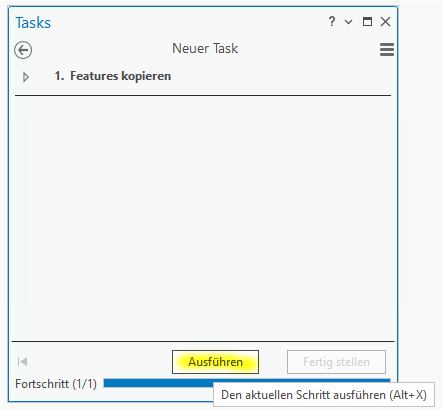

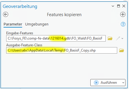

Mockup for better understanding:
1) Define task step as geoprocessing tool with parameters containing placeholders:
2) When executing task step the event "GPOpenedToolDialogEvent" is raised and placeholders are replaced:
3) When GP dialog opens the replaced (dynamic) parameters are used:
