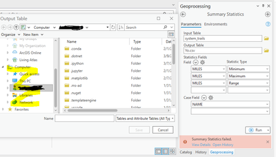

@ChristophKoschmieder Are you thinking of a programatic way to use these locations that are shown in the Browse Dialog?

Hi @JonathanNeal, no, my idea targets a more general use of *any* (windows / operation system) environment variable in parameter values for geoprocessing tools.
