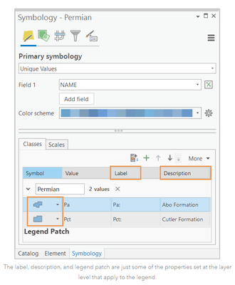

AubriOtis
Have you tried using descriptions? The tab isn't designed to work in the legend, but by using descriptions you should be able to get the output you want. Descriptions are set at the layer level, and only apply to some symbology types, including unique values. They are displayed in the legend and you can use spacing and font customization to get different looks. This blog posts talks a little about formatting and spacing in legends: https://www.esri.com/arcgis-blog/products/arcgis-pro/mapping/tips-and-tricks-for-working-with-legend...
Cheers,
Aubri
