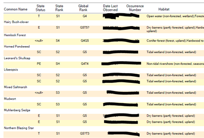

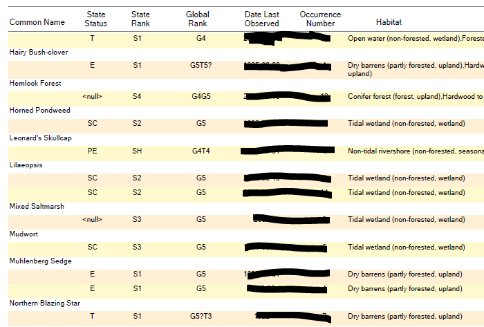

I want it to look something like this, where each plant species name is a group, because in some cases there may be multiple occurrences of said species:

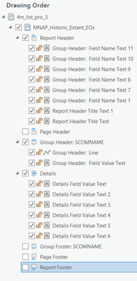

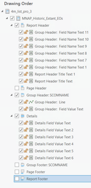

Pro report drawing order:
This results in the header on the first page, and each group on a separate page.

By default, group headers will export on a new page. You can modify this by selecting the group header in Contents pane > Format tab on the ribbon > General group > Uncheck "Start on new page"

Awesome, thank you! That is exactly what I was missing... and I did the same for the header and fixed that problem too. -Lisa
