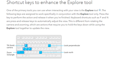

I had the spinning map and solved it my pressing the navigation short cuts  It also solved a previous error when the zoom was locked.  I also found if you accidentally press caps lock and left mouse rather than a shortcut key it starts the map spinning.
