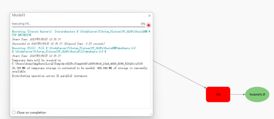

I am using a workstation with two Xeon Gold CPUs (32 cores) and 128G of RAM. I tried to fill in the pits of the DEM of the whole Tibetan plateau, and of course I divided the whole area into 12 separate parts according to river basins. However, during the processing, arcgis pro calls only one core for CPU and no more than 25G for RAM, which led me to spend a long time and the progress of the processing process was 0.

I understand what you mean. But the problem I'm facing now is that even if only one watershed is filled, Pro's computing efficiency is still very low, like what I've shown in the screenshot, the progress is completely 0. I once spent 5 days to compute an area but the progress is always 0. I had to force kill Pro's process because I don't know if it's really still working properly. I hope Pro can make full use of the machine's performance, even if it's just a processing can also use all the computing.

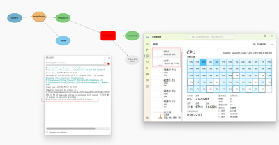

DrewFlater
There are around 100 of the most commonly used geoprocessing tools in ArcGIS Pro which can leverage parallel processing. Like you alluded to, parallel processing is not a silver bullet or one size fits all solution, so some tools use parallel processing in different ways. For some tools it is enabled by default to use all your machine cores in parallel, some tools use half, and some tools that support parallel processing do not do it by default. You can learn more about parallel processing in each tool reference topic. You pictured and described the Fill tool.
https://pro.arcgis.com/en/pro-app/latest/tool-reference/spatial-analyst/fill.htm
Here is the relevant excerpt.
This tool supports parallel processing. If your computer has multiple processors or processors with multiple cores, better performance may be achieved, particularly on larger datasets. The Parallel processing with Spatial Analyst help topic includes details about this capability and how to configure it.
When using parallel processing, temporary data will be written to manage the data chunks being processed. ...
By default, this tool will use 50 percent of the available cores. If the input data is smaller than 5,000 by 5,000 cells in size, fewer cores may be used. You can control the number of cores the tool uses with the Parallel processing factor environment.
You can try to set the parallel processing factor to 100 and see if the performance for Fill is improved with this setting.

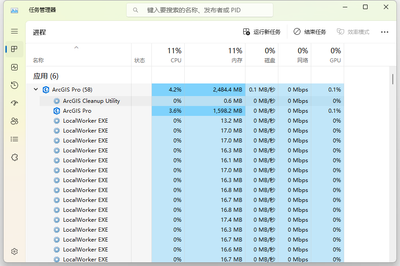

hello, I set the parallel processing factor to 100 and processed the flow direction, but the performance did not improve very highly. As you can see from the screenshot, only ~5% of CPU was used and only  ~10% RAM was used. Could it improve more?
