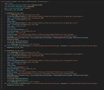

DanPatterson
MVP Esteemed Contributor
Som progress. but

TaiDuong
Not sure what y'all are trying to tell me here Dan. But here's yet another snapshot. Anyway , ignoring the fact I'm not a real developer and write sloppy code, if anyone has any idea why it's not working as desired I sure would appreciate it.
