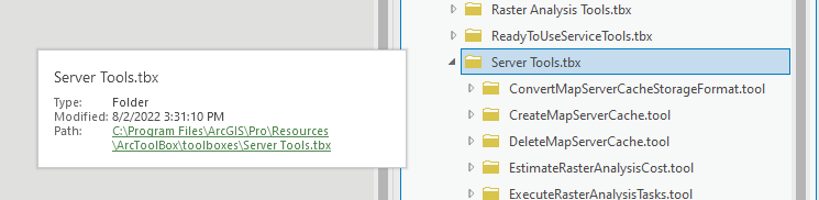

LaurenWinkler
@TanuHoque, I'm still having this same issue. Any updates on how to copy a toolbox in ArcGIS Pro 3.0?
Here's a screenshot for anyone else running into this issue.

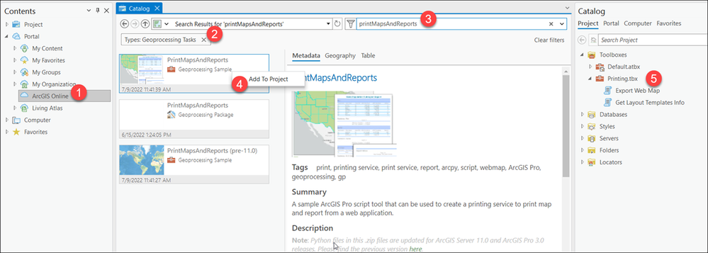

TanuHoque
One additional note. I have learned this trick from @DrewFlater. No need to download a zip file from AGOL and unzip and bring it in Pro... the entire workflow is integrated within Pro. Thanks Drew!!! That simplifies my life a lot 🙂
