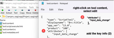

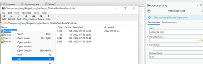

I messed with one of mine in a custom *.atbx
You need 7zip to edit the compressed archive
right-click on the *.atbx that you created.
then right-click on tool content, select Edit from there NOT the Edit menu on the top
The "key" was to find the key that is used in esri tools which in this case was an "attributes" parameter for the join field tool (input_data_change).
I added it to my tools parameter, saved it and it appears in the 2nd image.
