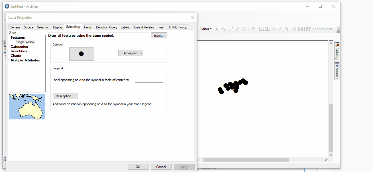

Changing symbology of a SDE point feature class in Pro 2.2:
Pro Symbology
Note how long it takes. Looking at wireshark logs while this is occurring, an incredible amount of traffic is going back and forth to SDE. Why? Because in Arc Map, I can change the symbology 5 times in the same amount of time it takes to change symbology in Pro. And guess how much back and forth is occurring with SDE when I do this in Arc....not much...
Performance gets even worse when you turn off caching for a map layer, which was the solution to BUG-000113527 ArcGIS Pro Attribute pane fails to dynamically update data for values calculated through SQL for published feature services.
The result of the bug that I logged on this in 2.1 is "Implemented in 2.2", so I'm hopeful that others in the community are experiencing this same specific issue: "Changing symbology in Pro takes 2-10 times longer in Pro than the same exact SDE data source does in Arc" and can get some attention on this issue that, judging from the other posts in this thread, probably affects a very large number of enterprise customers. I plan to reopen the case, but expect a "cannot reproduce" outcome......

ThomasColson
MVP Alum
In terms of data access, locally stored always is faster, in Arc and in Pro. However, with locally, there are other Pro performance issues. I just used what I think are one of your Py decorator examples to time stamp some common GP tasks. Everyone of them is slower in Pro/Pro Py. Neither behave nicely with SDE all of the time, IMHO, it's just Arc Map "chatters" less with SDE than Pro does. That much is evident from numerous traces, profilers, and perfmon counters. Back in the good old "T1 Line" Days, you couldn't even connect to a remote SDE with any ESRI product. So a lot of this is function of your WAN speed, but, like I exemplified above, even on the same LAN connection (a 7 MB VPN today), Arc outperforms Pro.
