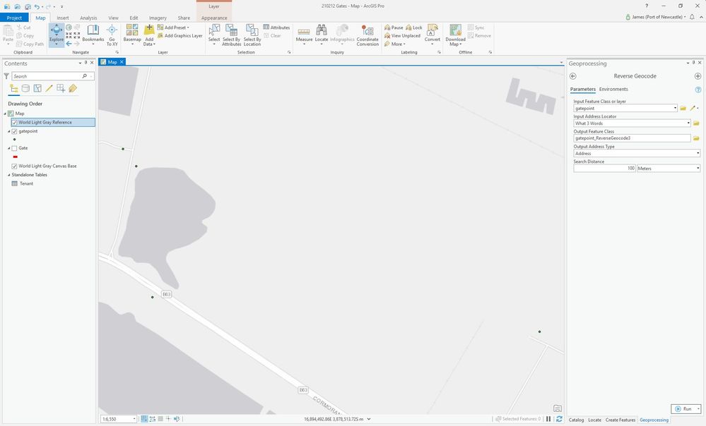

Hi @Robert_LeClair,
Thanks for this. The task I want to do is to give some private gates that don't have addresses some form of searchable location for emergency services. So rather than geocode an address I want to do the reverse, use the point locations of the gates to calc a w3w location. I tried every variant of the Reverse Geocode tool but Pro crashes everytime. I guess its not expecting a 3rd party locator.
Gates to geocodeGates to geocode
If I wanted to do this I think I'd have to code something up in Arcade or Python using a function in Field Calculator. Its probably quicker for me to do the 30 something gates manually. It'd be awesome if the tool in Pro worked as expected. Thanks for your help!

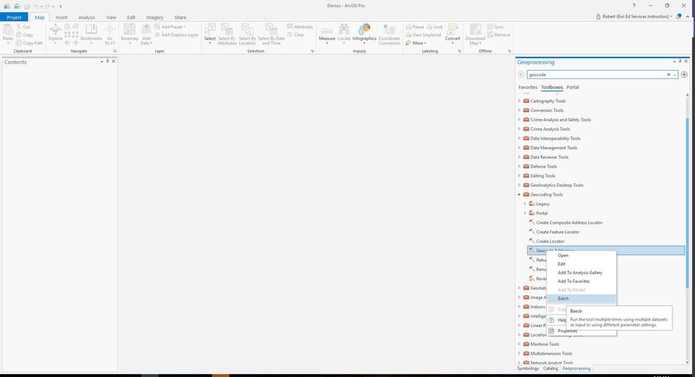

Robert_LeClair
Esri Esteemed Contributor
I'm thinking it's going to the Geocode Addresses GP tool, doing a right-click and Batch - see attached graphic.
James_OKane
Hi @Robert_LeClair,
