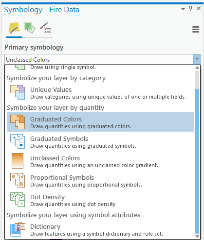

With the layer highlighted, go to the Appearance tab where you'll see the symbology dropdown.
Options for symbolizing by quantity are presented.

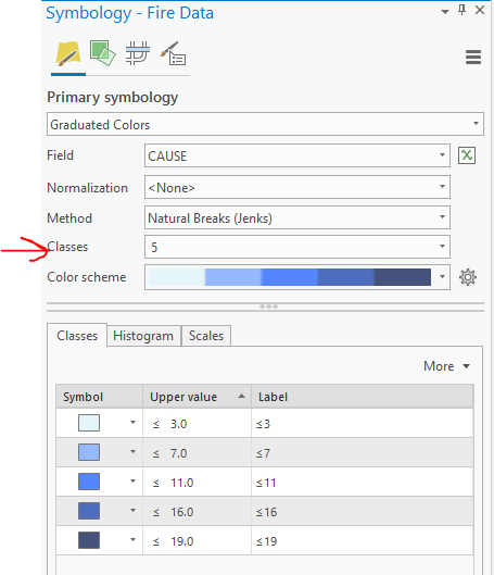

If you open the symbology pane from the layer (right-click > Symbology), you'll see the same options under Primary symbology:
And with an appropriate renderer, you'll be able to classify the data:
