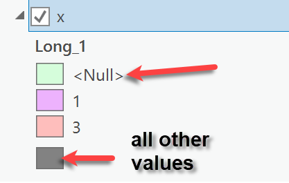

an example.  I kept <null> to show that they were all in the same class, the "all other values" category... I just edited that label to delete all text, but the color still remains.

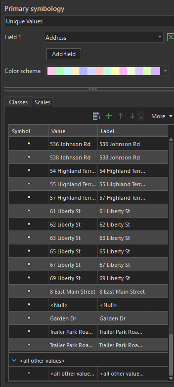

I'm using AGP 2.3.2 and the feature class I'm symbolizing has "Test" and <NULL> values for attributes.  I set my Primary Symbology as Unique Values, identified the field attribute for Field 1 and AGP created 3 symbols - one for <NULL>, one for Test and one for <all other values>.  I can remove <all other values> by clicking the More dropdown on the Symbology Pane and uncheck <show all other values>.

As in my example, you can also change the label for all other values without getting rid of it

This is how I was approaching it, but the problem is for unique values I have a bunch of different values. I want all points to be the same color except the null.
