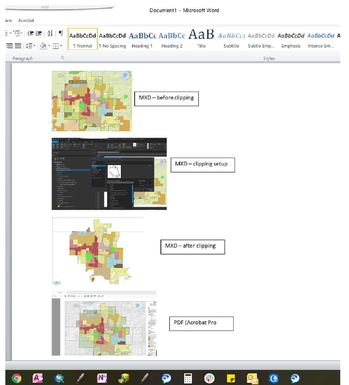

New release 2.3 PRO has a map properties option to clip drawing layer(s) beyond specified extent. I used the "Clip to the outline of the feature" option, then I specified which layer should be excluded from this clip. The project map looks fine. However when map is exported to pdf, it looses some of that setup and draws undesired layers beyond clip boundaries (therefore pdf is useless)

I am experiencing the same problem. The map is clipped and displays perfectly in ArcGIS Pro, but once exported (mine to jpg/png), some layers still extend beyond the defined clipping shape.
I found a workaround this issue. I made a copy of one of the layers that showed beyond the clipping boundaries in the export, changed its symbol to no fill and no stroke line. Called it Dummy, I then excluded the Dummy layer from the clipping. It somehow made the other layers disappear from the exported png file.

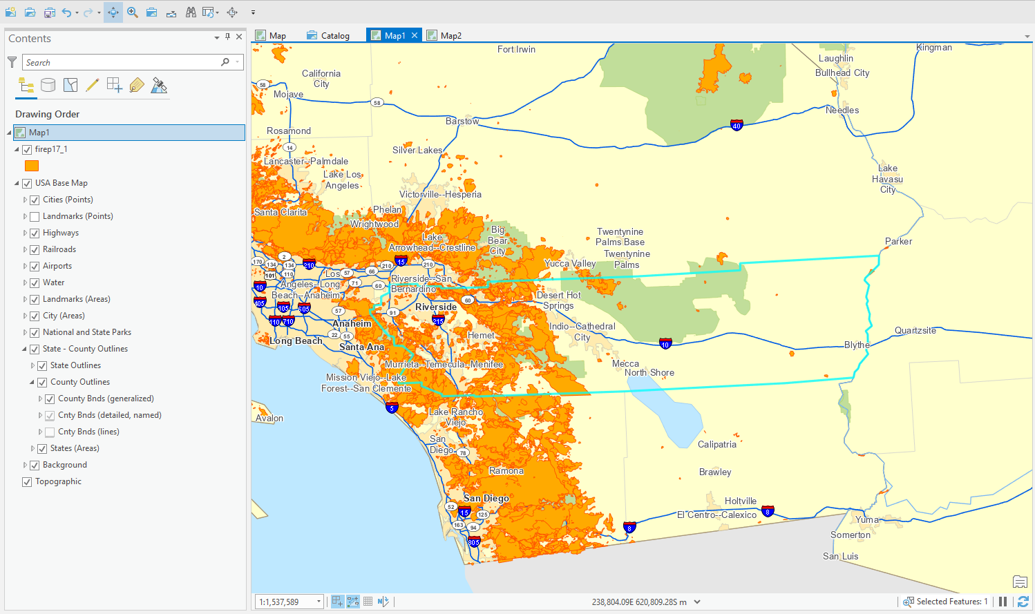

Map with no clipping:

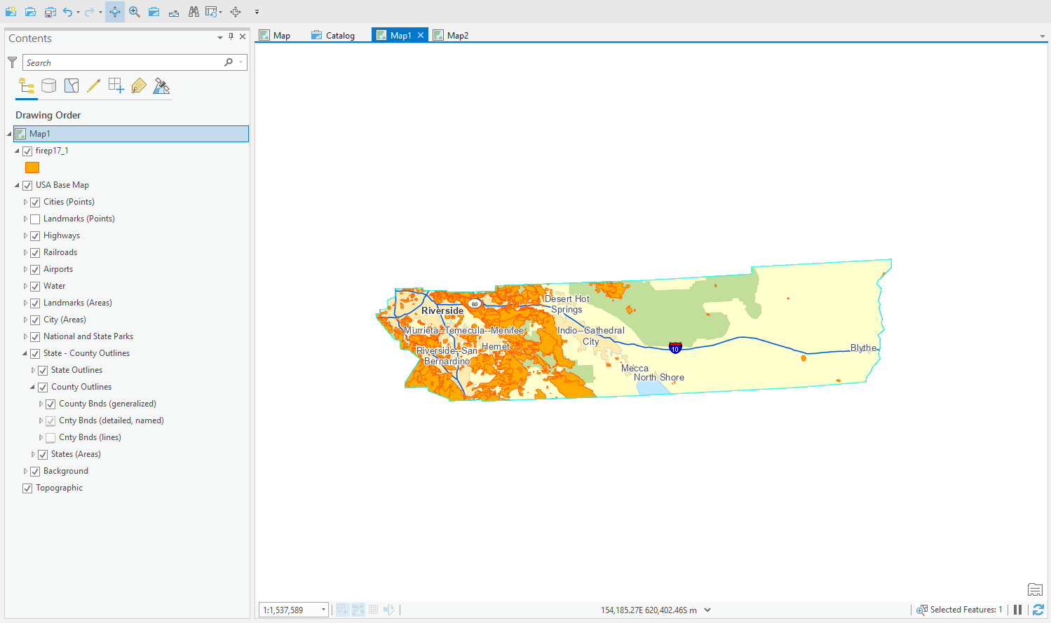

Clipped to Riverside county:
Exported to PDF and viewed in Adobe Acrobat Reader DC:

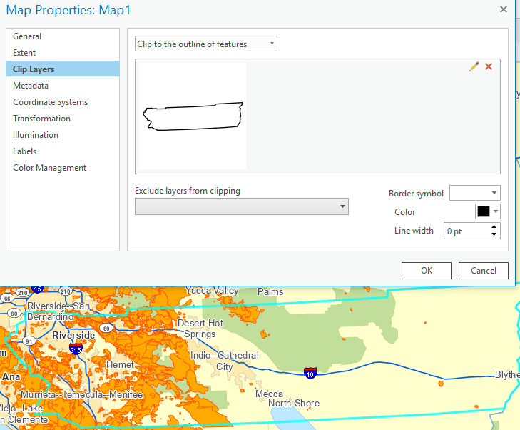

Here is how the clipping is set up:
'Clip to the outline of features' using the Selected option.

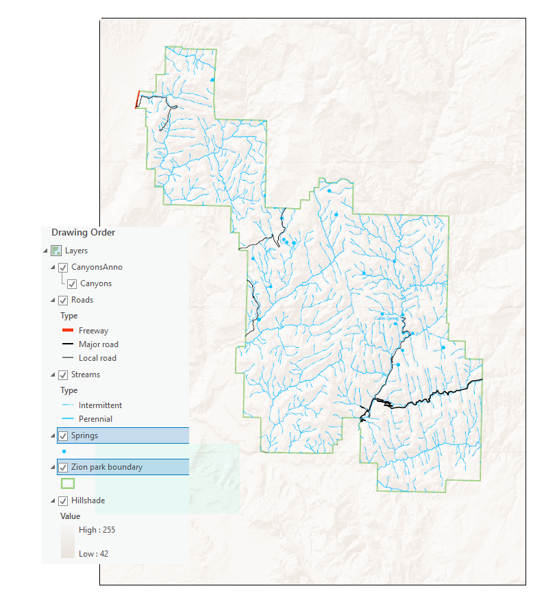

To recap, our support team was recently presented with this issue. A Project Package was provided that demonstrated this problem. We noticed the Clipping layer was in a group.
Using the Zion National park sample from the ArcTutor Data , we put the park boundary in a group and clip was not upheld in the PDF export. Removing the group resolved the issue in the tests.
If you're running into this problem please try ungrouping any problematic layers in the map, or feel free to contact Esri Technical Support if your still experiencing the issue or if you would like to have your account attached to bug record that was submitted. Ref BUG-000125378
