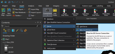

You will need to add the State of Hawaii's server to your project. To do that in ArcGIS Pro, go to the Insert tab, under Connections, and choose Server --> New ArcGIS Server:
For the server URL, put in https://geodata.hawaii.gov/arcgis/rest/services and then hit OK.
After that, you can add data straight from the State's server.

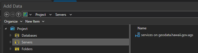

Go to Add Data --> Data --> Servers and choose the Hawaii server.
To find the dataset I was using, it's in SoH_Imagery --> Hawaii_DTM_elevation --> Maui_DTM.
