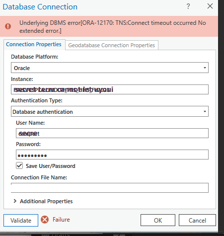

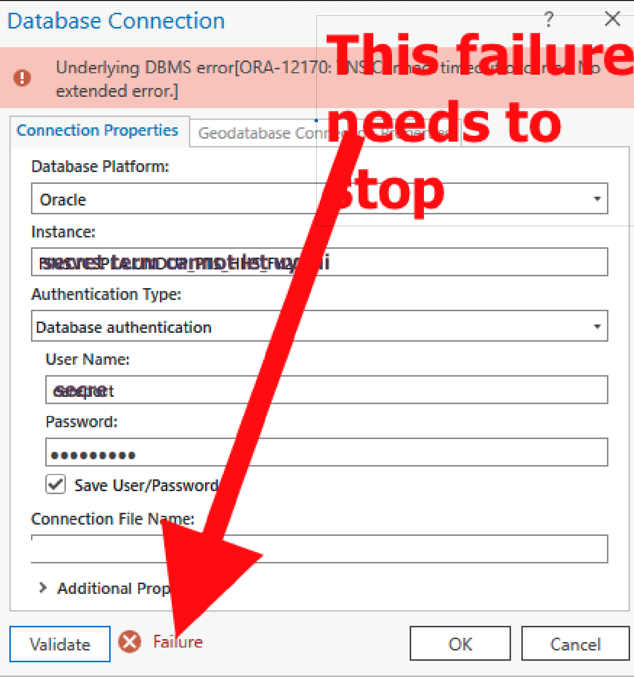

I cannot get ArcGIS Pro to make a connection to an Oracle database. The problem appears to be that I do not have the Oracle ODBC software installed with the "environment variable pointing to the installation of ArcGIS Pro."
I am sorry, but I have no idea whatsoever what it means to "point the environment variable to the installation" of other software. The documentation for the setup of this crucial environment variable provides no more hints on what that means.
This computer connects to the Oracle database thousands of times a day thoiugh oracle odbc.. Why can't ArcGIS connect once to the same database from the same computer?
What is this "pointing environment variable"?
What am I doing wrong, and how does it need to be done to work? This is a major point; I am so sick of this stupid problem that this company cannot find the English to make itself understandable.

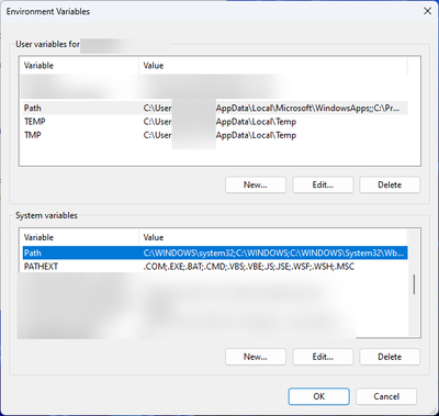

At this point, I am completely baffled by these words:   set the PATH environment variable to the location of the Oracle client.  I have been unable to rule out the possibiity of a connecton between the Oracle 19c client and the direct guidance from ESRI to set path evo
Another lead I am investigating:  There is a non-trivial reason to suspect the computer might contain more than one Path Environment Variable.
One of the reasons I am really lost on this point is I have been unable find documentation indicating which Environment variable to focus upon.

The PATH variable is in your system settings for the machine:
Make sure you have the Oracle 64-bit client (NOT 32-bit) listed in the beginning. If you are using the Oracle Full client, then it will add it to the PATH for you during the install / configuration.
Once you have the PATH configured, you will need to close and re-open ArcGIS Pro for it to capture the change.

Now I have the dbConnection working.  Fortunately, I cannot find the liittl box non the humdeds of buttons that is where I can enter signal to run in the new conection'
