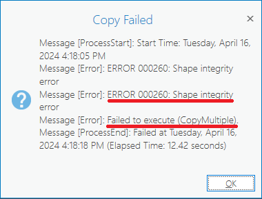

I'm troubleshooting an issue where I can't copy/paste a point FC via Catalog within the same enterprise geodatabase.
I get this error:
Copy Failed
Message [Error]: ERROR 000260: Shape integrity error
Failed to execute (CopyMultiple).
 That error message mentions something called "CopyMultiple". Is CopyMultiple a geoprocessing tool? I don't see any geoprocessing tools listed in the Geoprocessing Pane in Pro with that name.

Unsure if this'll be helpful.  Error 000260 looks to be what is thrown when the "Copy" tool malfunctions.
If you care to go a poking around in ESRI's dark underside, you'll probably find the actual stuff that makes the tools work here: C:\Program Files\ArcGIS\Pro\Resources\ArcToolBox\toolboxes\Data Management Tools.tbx  CopyMultiple.tool is the thing that "copies multiple datasets or tables" from one place to another.
Once I started using ArcPro, I noticed that some things don't work like you'd expect.  Instead of Copying your feature classes within your various datasets, I recommend Right-clicking on your destination database (as seen in your ArcPro Catalog window, under the Databases folder), and selecting Import, then Feature Class(es).  That should do it.
BBicking1
The CopyMultiple tool is non-public tool.
It runs when selecting multiple data in the Catalog pane to be copied and pasted to a different workspace of the same datatype.
