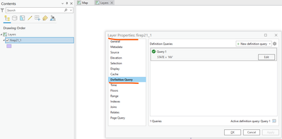

Hi @ErikFernandez
Open the layer properties > Definition Query
https://pro.arcgis.com/en/pro-app/latest/help/mapping/layer-properties/definition-query.htm
Does that work for you?

That does the trick, thank you. Not sure how I missed that. Lesson learned in the process, display filters are different than definition query, but similar.
