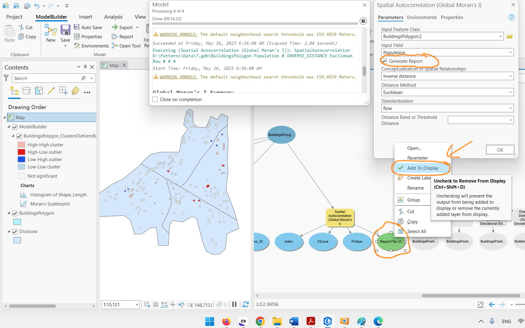

ArcGIS Pro 3.0.2:  The “add to disply” option fails to add the “report file” of the “Spatial Autocorrelation (Global Moran's I)” tool performed in the model builder,
I couldn’t figure out why the “add to display” option fails to add the “report file” of the “Spatial Autocorrelation (Global Moran's I)” tool performed in the model builder

add to display is for featureclasses/layers not tables or files
... sort of retired...

Then how this "report file" can be accessed or displayed?

Spatial Autocorrelation (Global Moran's I) (Spatial Statistics)—ArcGIS Pro | Documentation
Optionally, you can create an HTML report file with a graphical summary of results using this tool. The path to the report will be included with the messages summarizing the tool execution parameters. Click this path to open the report file.

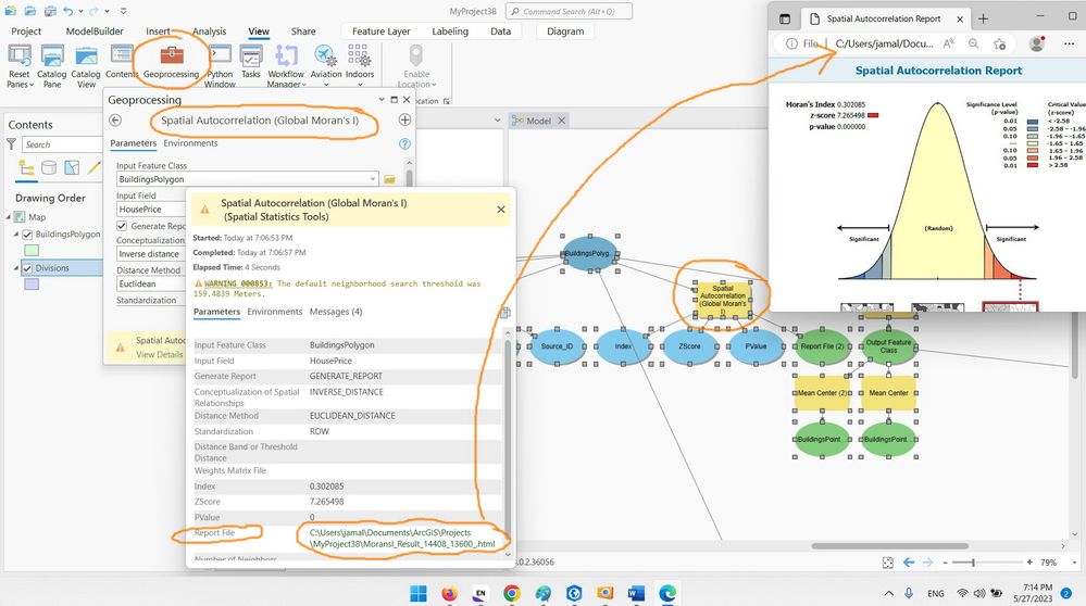

When performing the “Spatial Autocorrelation (Global Moran's I)” tool in a stand-alone mode (not within a model), the “report file” can be opened as per the screenshot below.
How to approach this link while working with the “Spatial Autocorrelation (Global Moran's I)” tool within the model?
