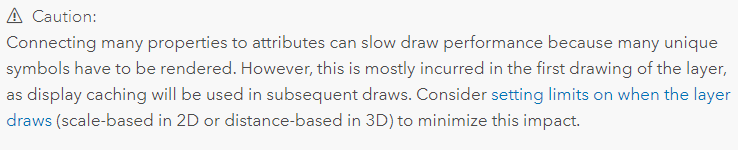

If you're using the unique value renderer in ArcMap and it works for you, you should probably just use the same in Pro.  Note that the standard renderers are recognized as a typical way to reflect different aspects of the data in the Attribute-driven symbology help: Attribute-driven symbology—ArcGIS Pro | ArcGIS Desktop
Don't overlook that note in the documentation about performance:
