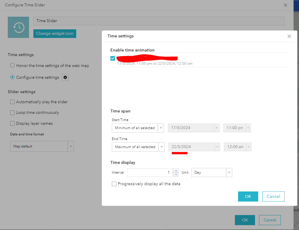

When I edit my web mapping applications time slider widget this is what I can see.
When I open the widget I guess it automatically calculates the max time, but this doesn't apply to the actual web mapping application without me opening the widget, and pressing ok, and saving the we mapping application again.
This should be automated. Why or how can I make this update automatically without me having to manually go into the web mapping application every day to do this?

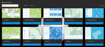

Looks like I don't have access to the instant app slider 😞

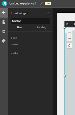

also cant seem to find a way to add a time slider to anything within the experience builder! Ill try google next.

The screenshot is showing other Instant App templates but not the Slider template so that is interesting.

There is a Timeline Widget in the ArcGIS Experience Builder that you add on top of the Map Widget.

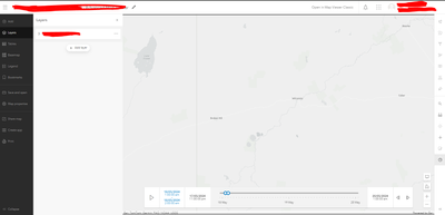

Where can I find the timeline widget? The map I have added has time series data enabled, and has a time slider on the web map view before I add it to Experience Builder.
the web map I've included in EB:
as you can see it has time series data, and a slider there.

Are you using the ArcGIS Enterprise deployment of Experience Builder by chance?  If so, the Timeline widget (Time Slider in ArcGIS Web AppBuilder) was added to ExB at the 11.1 release.  If you're using an earlier release of ArcGIS Enterprise, then the Timeline widget is not available.  You can learn more about the functionality matrix between Web AppBuilder and  Experience Builder here.
